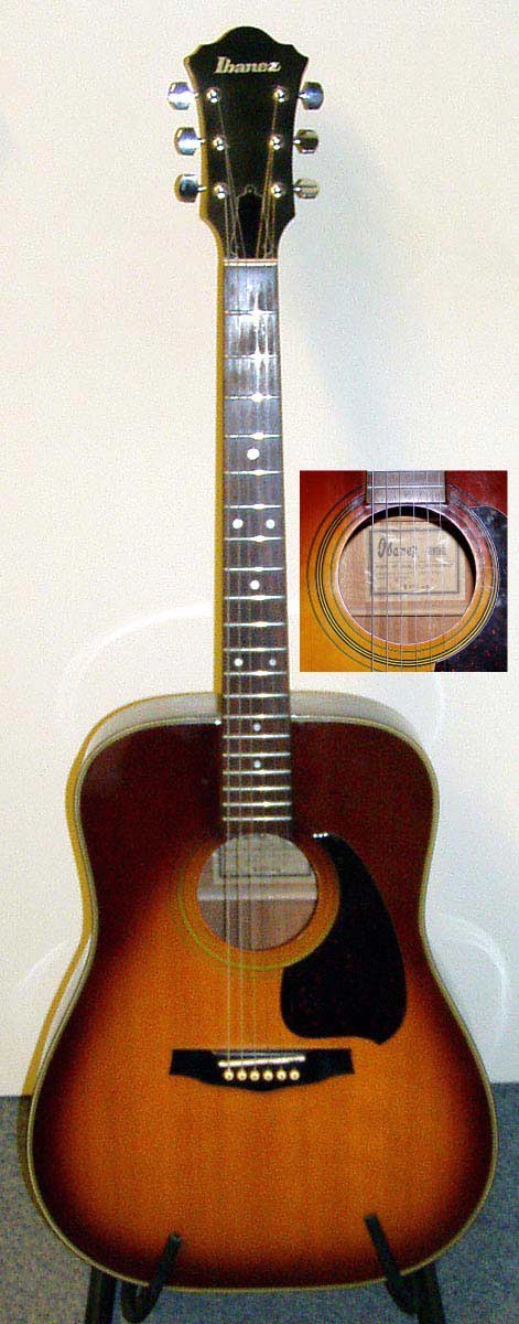

Thanks for your explanations Daniel, i was only asking that because that shape looked strangely familiar to the one on my Ibanez dread, less pointy than yours actually, perhaps Ibanez people were inspired by Washburn bridges ? here's a pic
